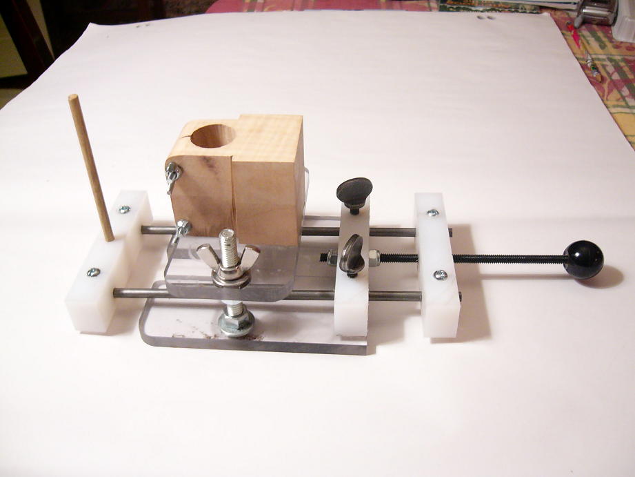

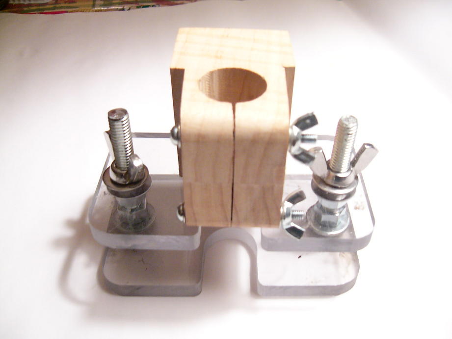

Talk about form following function! Nice design Terry. I like it. I just scavenged materials together for Sylvan's model. Now I'm not sure which way to go. Maybe some hybrid of the two.

PostPosted: Sun Dec 17, 2006 7:30 pm
Posts: 2711
Location: Victoria, BC
Last Name: Abercrombie
Terry-
Very elegant jig.
Which model PC laminate trimmer/router is that?
I notice it is unusual in that you can completely detach the base, and still retain the factory depth adjustment.
That's a nice feature- not common in the ones I've seen.

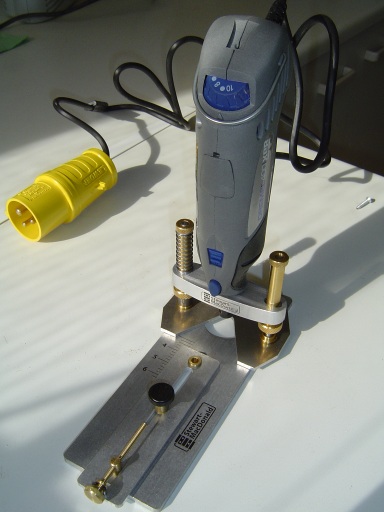

Like Hesh, I too use the Stew Mac base with a Dremel, I use the newer circle cutter base and a 400 series Dremel. The runout on the older Dremel seems to have been solved with the new one, and I'm more than happy with the results. I too use the Stew Mac downcut bits and also LMI end mills. As I'm only cutting 1.2mm deep slots in spruce or WRC I have never felt the need to use a 1hp laminate trimmer for the job, even if the dial does go up to 11.

I use the Stew-Mac base and rosette cutting attachment with a dremel. Old base, so no micro-adjust. I'd like to have the new one with the micro-adjust, but I've never had much trouble with the old one, so it doesn't rise to the top of the priority list.

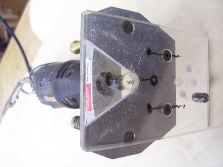

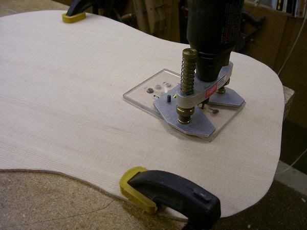

PostPosted: Mon Dec 18, 2006 9:04 am

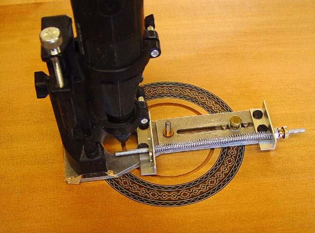

Like I said I use the StewMac base and a dremel or my Foredom, but one thing that keeps coming to my mind and has finally driven me to a new bout of NTAS (new tool acquisition syndrome), and that is not being able to see both edges of the channel clearly. I could build a new base out of lexan but have decided to enable my affliction of NTAS and buy this puppy.
This should scratch my itch for the rest of this year MichaelP39069.7153240741
PostPosted: Mon Dec 18, 2006 11:10 am
Todd if I was making mine again -- I now know what it would look like! Very clever and functional!

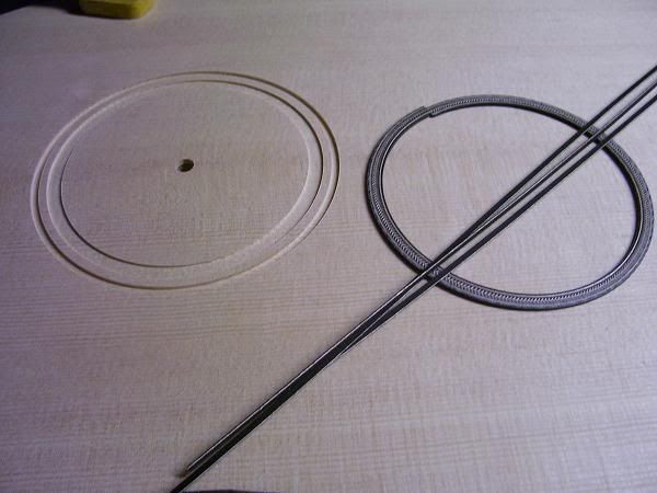

PostPosted: Tue Dec 19, 2006 3:38 am
Posts: 493
I've used this on 3 rosettes without a hitch. Pretty simple but it works. It has an old 5/16" pilot from a router bit that is threaded into different holes to get the different diameters.
I have a snug fitting hole in my workbench for the pivot point.
